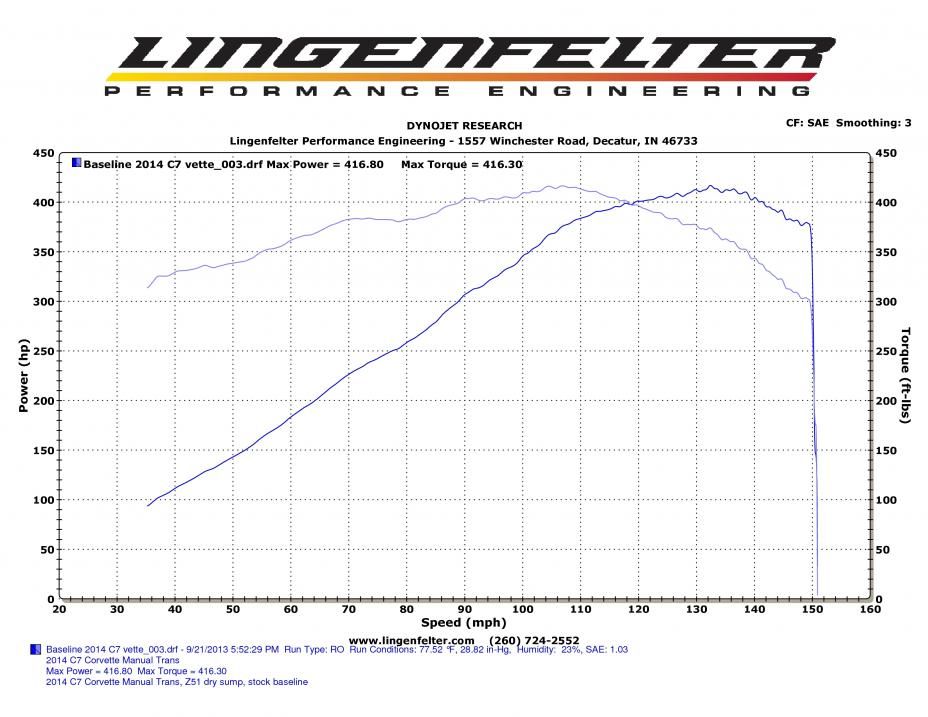

Lingenfelters chassis dyno shows the following
On LPE rollers the Stingrays LT1 put down 416 rwhp and 416rwtq. This car was equipped with the new 7 speed manual transmission.
http://i1202.photobucket.com/albums/...rn/LT1dyno.jpg

Some analysis, just for consideration here...
A "typical" ≈ 510hp 5.7L LT5 w/ stock cams
http://i185.photobucket.com/albums/x...T510-19-10.jpg
comparing to the C7 LT1
http://i185.photobucket.com/albums/x...ps72b4c85d.jpg
To make it simpler, I took the liberty of converting the mph to approx rpm (simple proportion assuming torque/power crossover at 5252 rpm @ 118 mph):
MPH Aprox rpm
40 1780
50 2225
60 2671
70 3116
80 3561
90 4006
100 4451
110 4896
120 5341
130 5786
140 6231
150 6676
160 7121
This could explain (again) why the LT5s come into their own on the "big end" of the quarter mile or even half mile contests... Power under the curve!

Thanks for doing the MPH/RPM conversions, much easier to compare.
The 510hp packaged LT5 certainly outpowers the stock GEN 5 LT1.
'Power peak of LT1 is 6000rpm, roughly 6700rpm for the modded LT5.
Modded LT5 is down over 25 lb/ft at 2000rpm.
At the torque peaks the LT1 is up 39 lb/ft torque with 416 rwtq at approx. 4700rpm LT5 is 377 rwtq @ 5000rpm. The LT1 does have an extra 26 cubes though.
Another consideration is weight. The C7 Stingray curbs out at 3298 so 3300lbs. The only ZR-1 spec I could find was 3505lbs, with the non-ZR-1 coupes specced at around 3300-3350 lbs.
I will give the GEN 5 6.2l/376cid credit though. The GEN 5 6.2 LT1with 465lb/ft@4600rpm comes within 5 lb/ft torque of the GEN 4 LS7 and its 470 lb/ft torque@4800rpm.
