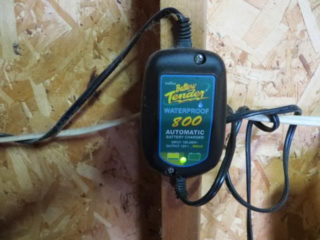

Better, perhaps to disconnect than not to, due to parasitic current draw (PCM & maybe the CCM too = 'keep alive'. But, a lead acid battery will sulfate and loose a few % of the plate surface area every month. There are several "smart" chargers on the market now, and personally I like the little 800mA Battery Tender. It keeps the battery fresh and still provides the "keep alive" current for the ECM, etc.
I've had one on Ami's Vette since 2005, still fresh as a daisy, and now I'm getting kinda curious how long it might last! The battery in the Z has been there since 2007; both are Wally World batteries, and it too is fresh to this day.

I purchased a battery tender from O'Riley's autoparts, 12v @ 750mA for $41.99 plus tax. Good investment. After reading the instructions, it says you can use it with the battery connected or disconnected. If connected, ground the tender to the chassy and put the positive line to the battery. I went ahead and left the battery connected and grounded the battery tender to the chassy per the instructions.
