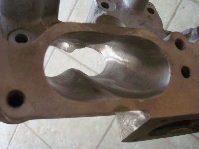

and now that the easy part is done, you can start doing this.
