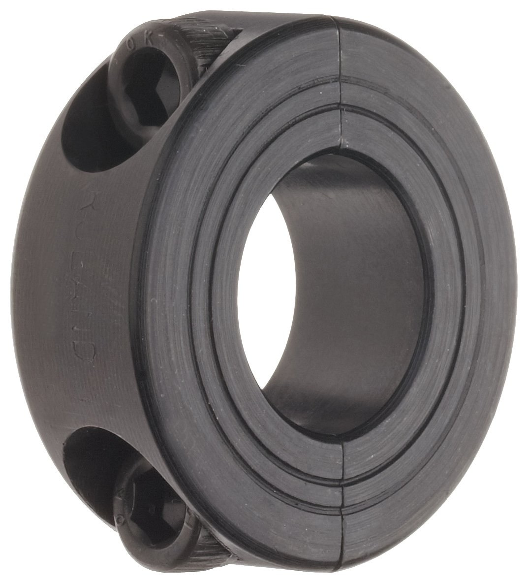

Hey guys, the ZR-1 is still on the lift. Installing the RAM conversion we observed that the slave cylinder fittings make contact with the pressure plate. So I need to limit travel.
I'm going to limit travel at the MC push rod by installing a split-clamp on the rod. Just need the diameter so I order the right part.
I'm waiting on a few parts to complete assembly so I won't be near the car for the next few days.

0.291" dia. Part with reservoir. Not sure that is what you were asking for. George

That's it, the MC push rod. Thanks, going to try and put a small split clamp around the shaft near the eye to limit hydraulic release bearing (HBR) travel.
Got a 7mm steel and a 1/4" teflon split clamp.
