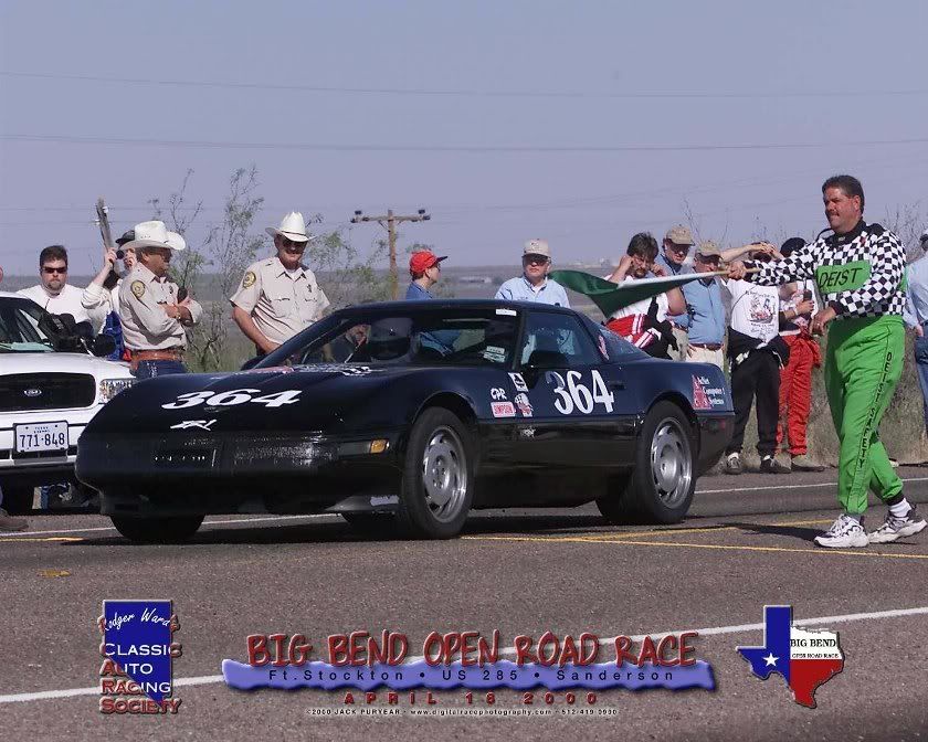

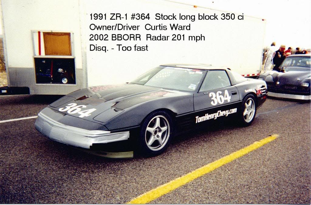

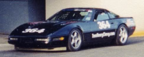

OK GUYS CURTIS EMAILED ME THE PHOTOS OF HIS ZR-1 IN THE BIG BEND OPEN ROAD CHALLENGE FOR ME TO POST HERE SO YOU ALL CAN SEE HOW HE SET UP THE Z FOR THE 201 BEST IN 2002. NOTICE HOW THE Z WAS MUCH LOWER BETWEEN THE 2000 VS THE 2002 RUNS. THIS IS WHAT CURTIS IS TALKING OF GETTING THE Z NICE AND LOW. HEY CURTIS WHAT IS ALL THE DUCT TAPE ABOUT? IS THERE A CONCERN ABOUT AIR GETTING IN THE FRONT AT THE PLATE AND TURN LIGHT OPENINGS? BTW HOW MUCH OF A BLUR DOES IT BECOME AT THOSE SPEEDS? I IMAGINE QUTE A "TUNNEL VISION" EFFECT HAPPENS AND TIME STANDS STILL FOR THOSE BREIF MOMENTS WHEN YOUR AT THE MAGIC 200 MARK----

HERE ARE THE PIC'S OF #364
Yes...that's how I eventually want to get mine to squat down to keep the air from getting under there. 1st things 1st (P&P, pc, headers, etc) though.
