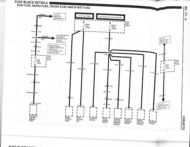

Anyone have an electronics diagram for this circuit?

yeah let me go look
Old 01-26-2011   #13
Default Re: 91, No Power Mirror or Cruise and Blown Fuse

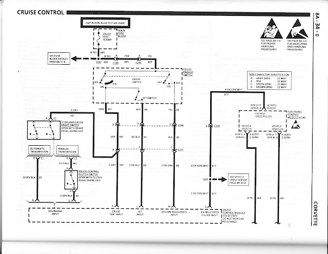

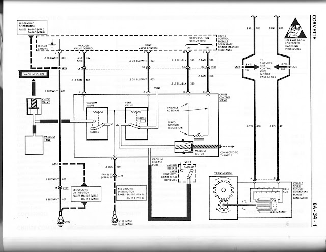

Cruise fuse covers a lot more then Cruise only..
if you need other pages let me know
here is a link to the album where you can get the full size scanned images
http://picasaweb.google.com/vettxtc/2011_01_26#
Indeed which is why I suggested finding every system tied into that fuse. Any update on this was the culprit found or is it a work in progress? GC
Yep and if it blows when the cruise engages then it narrows it down.
