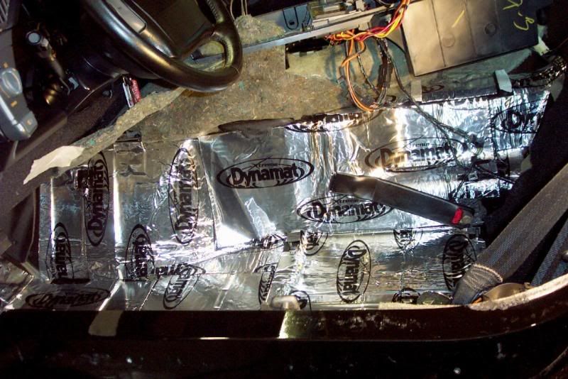

This is my own personal car. This all started with removing the dash to replace a module. Well, while I was at it, it snowballed into a monster project.
1) Completely stripped the interior out
2) Installed sound deadener
3) Install a new headunit
4) Reroute all stereo wiring
5) Steam clean carpet
6) Repair fiberglass

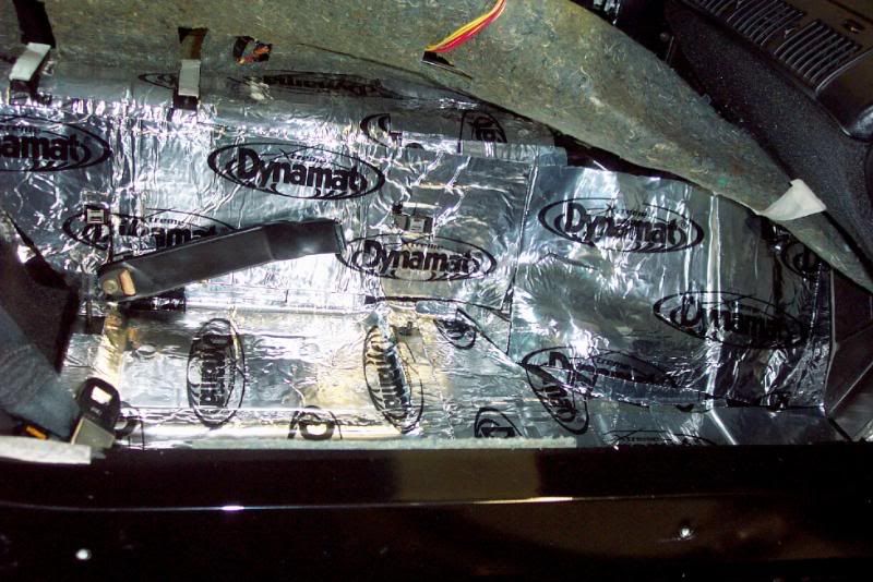

When you took out the dash did you see where the heater mix door/actuator is? Mine needs replacing and told the dash has to be dropped. If you saw it where in the third pic would it be and would it have to be totally dropped? Thanks

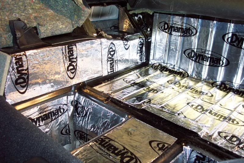

Used ~40 sqft of Dynamat for floor and hatch area. Used another ~9 sqft in the doors. Hatch area:
Passenger seat area with Dynamat over top of the tunnel.
Drivers seat area with Dynamat fitted up to the edge of the shifter boot.
