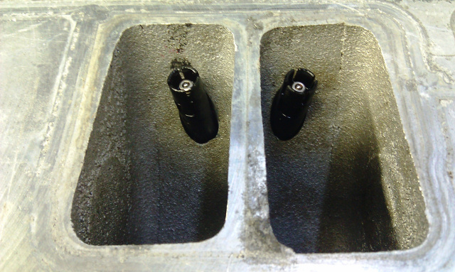

Using the marine intake allows me to get rid of the problematic CSFI poppet valves which look like these. These flow at 23.1 lb/hr at 63 psi of fuel rail pressure. I am now using standard EV^ injectors with USCAR connectors which flow at 25lb/hr@43.5psi or 28.9 lb/hr @ 58psi(4BAR) of pressure. These are actually the same injectors which Todd suggests be used in LT5 apps.
This stock CSFI injection spider does allow for precise injector targeting. Pictured is the actual spray end of one of the 8 spiders legs. That is a mechanical poppet valve
