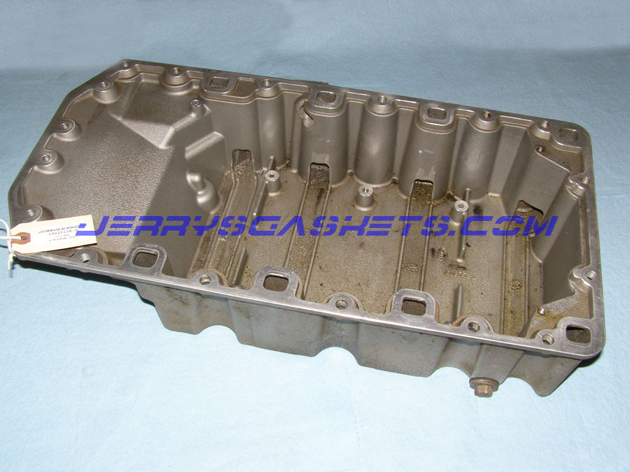

There are 4 oil drain conduits from the cylinder heads, down through the cylinder block and into the oll pan exiting UNDER the baffle. If you will note, one of the 4 conduits is in the far rear corner of the cylinder head, right by the camshaft. The conduit is sealed with the head gasket and the oil pan gasket all the way down to within an inch or so of the very bottom of the oil pan, where an errant cam plug could exit underneath of the baffle tray.
Head gasket
Pan Gasket
and, the Oil Pan (note the exit from the drain back conduit at the bottom of the pan
Head gasket
Pan Gasket
Thanks Jerry! This is sounding like a very feasible scenario. The cams are stock. Sounds like there are differing opinions on the size of the plugs though? Can we get a consensus on the size of the plugs? Anybody have one they can actually put a caliper to? or any other plug in that area that could conceivably make its way down one of those 4 passages from the cylinder head? Judging by the pics of the windage tray and Marks input regarding clearances as well as the fact that the crank plug I bought doesn't match the plug I found I think we can discount the idea that it came from the crank.

I suggested the rear cam plug a while back, it does appear to be too small, it is 3/8 roughly across the threads. picture is of the early cams '90 - '92
Also I agree with marc, that tray is pretty tightly spaced, I do not think a .525 plug will make it passed the tray
Also I agree with Jerry that the cam plug can sneak down an oil port
I just do not see another spot where a .525 plug can come from based on looking at my bare heads and block.
Is it possible that some cams have a rear .525 plug?? or are they all identical.
