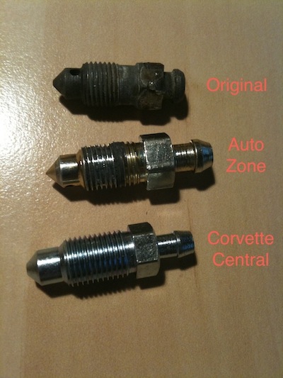

I want to replace the bleeder screws on my front calipers and I'm having trouble finding an exact replacement. What I've purchased from AutoZone and Corvette Central don't match -- the threads are longer for starters. Any problems using the ones from CC? Anywhere I can find originals?

Gm dealer is going to be your only bet. however it makes you feel any better I used the ones from autozone about two months ago and had no problems

I am in the exact same situ. Bought replacements from NAPA on Monday - they look like the corvette central ones.I did see that Corvette Specialties (I belive) had them on their site -and they looked like an exact match to original

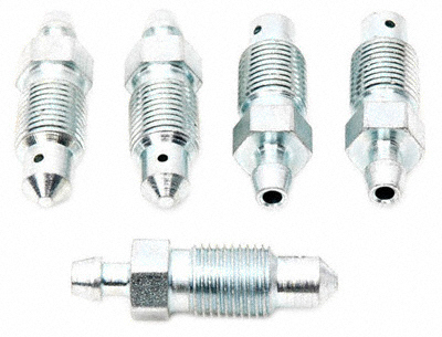

RAYBESTOS S23925 Brake Bleeder Screw
they will work but are longer it however makes no difference

Corvette Specialties -CA-34165 84-99 Caliper Bleeder Valve
Appears to be the exact match if you want to go that way

Don't use the Raybestos screws. I picked up those to replace my OEM's which where a bit banged up. Well, I simply could not bleed the caliper effectively with these screws (using my hand vacuum pump). The holes in these screw are smaller than OEM. I either got no flow, or lots of air. The stock screws worked fine.
