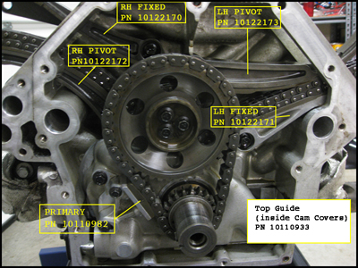

Here's a picture of the chain system for reference.
Something is not right with the chain tensioning system, which really needs to be resolved. Even if the facings broke or fell off, the chain just does not normally ride that high above the sprockets when properly tensioned. The cam-cover chain guide facings usually don't incur much wear.
